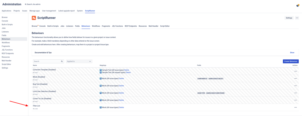

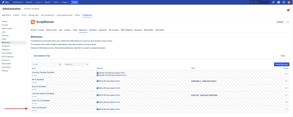

Below is a screenshot of the Behaviour configuration:-
Below are a couple of test screenshots for your reference:-
1. Firstly, a test is run when the Behaviour is disabled, as shown in the image below:-
2. As expected, the list is not filtered, and all the options are available as shown below:-
3. Next, the Behaviour is enabled as shown below:-
4. As expected, the List options are also filtered accordingly
