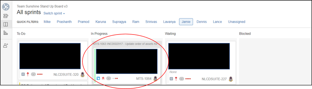

We have assignee filters on our board (filter query is assignee = ######[employee ID]). User selected his assignee filter (assignee = 904409), and it does not show any issues. (See below)

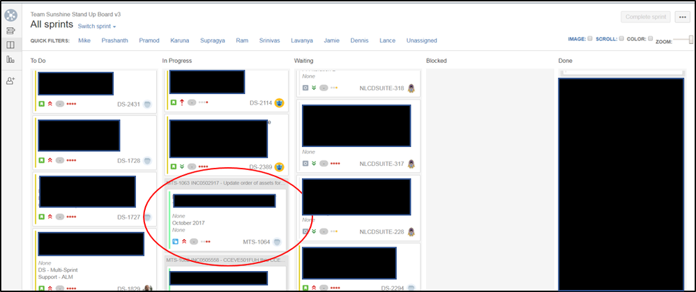

But if I remove the filter (show all assignees), his issues show up (see below):
I have reassigned the issue to myself, and it shows up for me on our board under my filter (see below):
