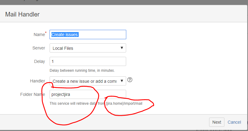

chandra bhushan May 29, 2018
@Nic Brough -Adaptavist- suppose i have created IMAP folder called projectjira.
i have mentioned same in handler.  i am confused like folder which i have created is inside outlook and how jira is hooking up with outlook?jira1.PNG
above image is how mentioned the IMAP folder during handler creation.
now can you suggest where i am going wrong?
May 29, 2018
No, that is not a IMAP folder.
You have set the email handler to look for physical text files on the Jira server.  That has nothing to do with an email server (unless you've got a local incoming mailbox that stores mail in that way, which is typically done by "mail" programs on unix boxes, or you have set up something in your mail server to do an export to file when it arrives)
Go back to the handler and change it back to looking for email on an IMAP server.
Alexey Matveev
May 29, 2018
Open the Server field on your screen. There must be IMAP mail servers. If they are not there, then you have to create an IMAP email server in the POP / IMAP Mail Servers section.
