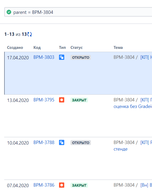

Hello! Tell me, is there a possibility in a task with the type Subtask to display its subtasks? I see that the list of subtasks is available only for non-subtasks.

Hey, Nic! Thanks for your answer. I prepared screenshots in English. I hope you can see that a task with the subtask type has child subtasks.

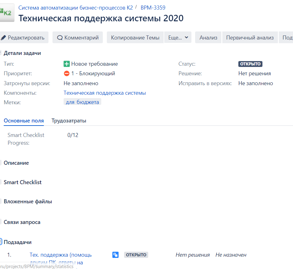

See, a task with the subtask type has subtasks if you build a query in the filter (see screenshot 2), but the task doesn't have subtasks on the form (screenshot 3). For comparison, in screenshot 4, the regular task on the form has subtasks on the form ( at the bottom)

It appears you have the addon Smart checklists and are confusing checklists as Jira sub-tasks. So going back to your question let me try to rephrase your question...
’When viewing a task that has sub-tasks can I have that view also display the underlying checklists of those sub-tasks?’
the answer to which is no AFAIK. You might reach out to the vendor of the addon and inquire further.

It definitely has nothing to do with Smart Checklist. But in case of questions related to our addon - feel free to contact us smartcheckilst@railsware.com
However, it looks really strange when querying for parent=BPM-3804 (which is a subtask) you get set of other issue types.
