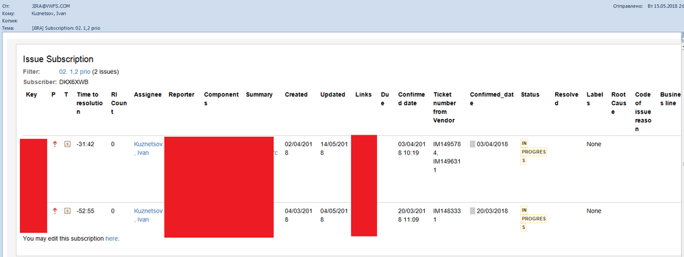

@Gowtham BYou have to create and save your JQL filter. After that you have to go: Issues-Manage Filters. In right screen side you will find Subscribe buttons vs every saved filter. If you click Subcribe, system will display screen, where you can configure report period and subscribers.

Subscription to JQL filter - there is only Issue list, which you will peridiocally receive via mail:
