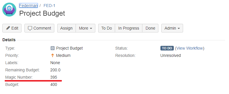

Just a quick update, here is a screenshot of it working on a basic test project. The issue that has the expense has a value of 5.

I’ve setup a mock environment with your use case again to get this straight. I’ve spotted two issues, which I hope that when solved, will fix this script for you.
Null Pointer Exception
The null pointer exception you are getting states:
Cannot invoke method minus() on null object
I am certain that this is because it cannot find a value in the budget field on the “Project Budget” issue that the field is running on. I have reproduced this issue in my local environment, and get the same error as you. As soon as I put the budget value back in, I get the correct values and response back. You need to triple check that the issue you are testing with, definitely has a value in the budget field.
Incorrect Value
We have had a continuing theme that we can’t seem to get the subtraction to work. You always appear to end up with the “Remaining Budget” matching the “Budget”. I’ve done some investigation on this and this is happening because we are looking at the wrong side of the budget for the expense value.
In order to solve this issue, if you switch to looking for inward links, then you need to change this line:
def linkedIssue = issueLink.destinationObject
To this line:
def linkedIssue = issueLink.sourceObject
I hope this helps clear up your issue.
Scott Federman
January 4, 2018
ding ding ding!!!! Nice one. It is working. Thank you for everything on this. HUGE HELP.
