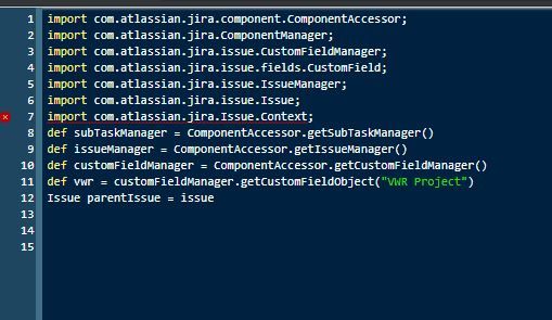

What i have done is created a script runner field in jira
and i coding that field in script runner plug in.

Aasha Kathamuthu June 7, 2019
@Tu
"VWR Project" is a single select choice field.
We have created a field (script runner ) type field - (Parent Project Name)

Even I could not get the entire point, you can start with this code.
import com.atlassian.jira.issue.MutableIssue; // also add this import
def vwr = customfIeldManager.getCustomFieldObject("customfield_10xxx") //type your customfield id here
Issue parentIssue = issue.getParentObject();
def parentVwrValue = parentIssue.getCustomFieldValue(vwr);
def mIssue = (MutableIssue)issue;
mIssue.setCustomFieldValue(vwr, parentVwrValue);
Hope it helps
