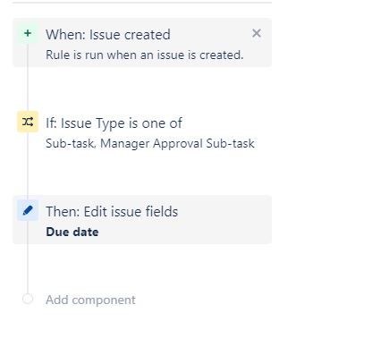

Lesly Cracchiolo September 24, 2020
Hi @John Funk,
Is it possible to use this configuration? (see screenshot). If yes, what do I need to put into the due date box to have it trigger from the parent's End Date field?
Thanks! :) one.JPGtwo.JPG
