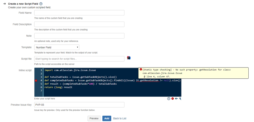

you forgot to include an import:
Sarah Pinns April 25, 2018
Ivan Tovbin
April 25, 2018
My mistake, forgot the parenthesis. It should be like this:
def completedSubTasks = issue.getSubTaskObjects().findAll{(Issue) it.getResolution() != null}.size()
