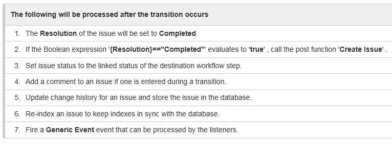

I have a transition for closing an issue.  I want this to create another issue during this transition, so I used the Universal Post Function's "Create Issue" function (seen below).  However, when I run the transition, I get an "Issue Does Not Exist" error.  The transitioning issue is still there and successfully transitioned, but there is no generated issue.  Also, my end goal is to create a linked issue in a separate project with a separate issue-type.  Is this possible?  I'm running Jira 6.3.3 with Workflow Enhancer 3.2.Create_Issue blues.png

Can you place the 2nd post function below the "re-index" post function and try again? I would assume that the bool expression returns false because the resolution at that point is still null.
