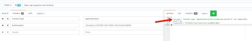

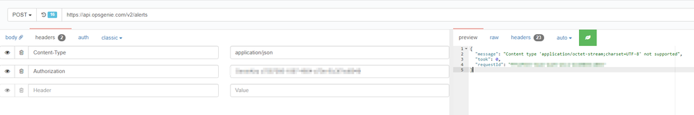

Hi all, I am trying to create an alert via the API. But I run into some problem using the POST. Before this, using GET with list alerts is working fine.
As you can see in the screenshot I am using:
Content-Type: application/json
Response: Content type 'application/octet-stream;charset=UTF-8' not supported
Any idea?

Ok, thanks for checking. That error is pretty specific, and mentioning the wrong Content Type might be being used (which I understand contradicts your screenshot):
Bart Scheltinga
May 9, 2022

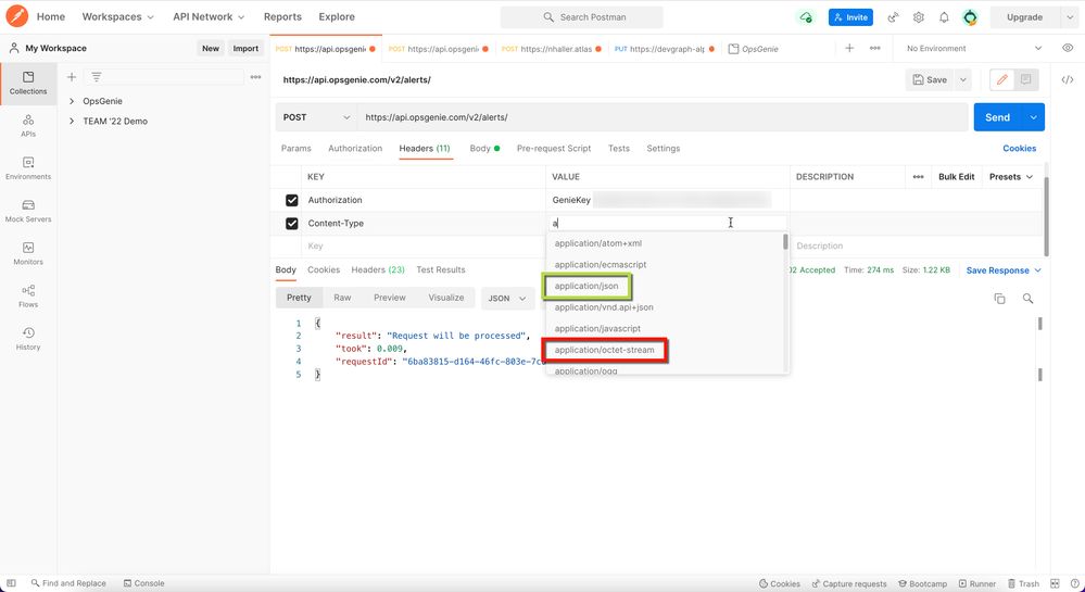

yeah strange, right? Maybe I should use postman for testing instead, just to rule that out.
Bart Scheltinga
May 11, 2022
I installed Postman (just like you). Now the request works so the problem seems to be on my side!
