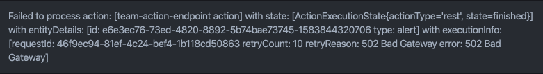

I just did a couple tests on my own account with an action tied to a request bin site (https://beeceptor.com). When I configured the request bin to reply with something like a 502 status code, Opsgenie retried the action 10 times then logged the response:
So it did take a minute or so to go through the retries, but logged the status code afterward.
Do you at least see these entries for the action you've set up? Or are you only seeing the action was sent and/or failed?
