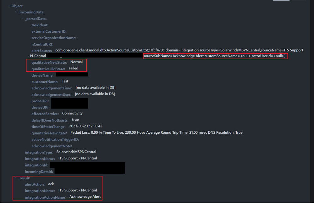

- This sent the information to Opsgenie and looking at the logs (see attached raw log format in opsgenie)
- It does appear to be sending over the "new state" as Normal and there had been no acknowledgement from either side
- However, the alert within Opsgenie is still open - and just classes it as acknowledged
Please see the additional attachment for the ack note on resolve. As you can see there are no user data pull through, (whereas when ack in N-Central it pulls the users name), and this "note" as well as the acknowledgement action, was triggered on the Resolve from N-Central (as shown in the log)Raw log format on Opsgenie alert w-o acknowledgement.png Ack note on resolve.PNG

The two conditions are actually:
  • New state = Normal
  • Acknowledgement Time = Empty
Above in your screenshot, the Ack Time field is showing as [no data available in DB] - which I assume is an actual string? You can check the log by reviewing the Raw tab of it to be sure.
Michael Hodgson
March 27, 2023
Hi Nick,
Performing a few additional checks, I can confirm that even on resolve and no acknowledgement from either Opsgenie or N-Central side, the "resolve" is coming in as an "acknowledgement alert" regardless
The logs, are similar to what I've sent previously. This is from the opsgenie logs and Raw format.
This is the log triggered after N-Central marked a "resolve" on it's side, and the data received seems appropriate e.g.
- QualitativeOldState = Failed
- QualitativeNewState = Normal
- The "no data available in DB" is what it sends across when no one has acknowledged from N-Central side
(If they do acknowledge on N-Central this data is of course, populated)
Based on this - this appears to meet that criteria you mentioned of new state = normal, and acknowledgement time = empty - as you can see in the screenshot
