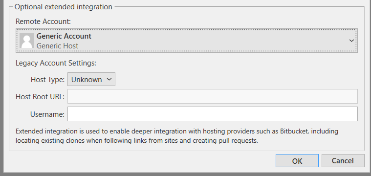

I found a work around,
Click on Settings : launches Remote Settings
Under Remote tab > Select the Remote repository paths and click Edit: launches Remote Details
Click OK on Remote Details
and again Click OK on Remote Settings
I find the red exclamation disappears letting and establishes connection to Bitbucket properly.
It would be good to know why it behaves this way and what is a permanent solution to it though.
Thanks for the tip. I tried this however I still have the ! on the Remote icon. If i get it resolved I will post an update.
Going down the path that Rinee_Bhattacharya mentioned led me to what I think the real issue was for me. I noticed that the "Remote Account" setting was set to some "Generic Account". Switching this to the correct remote account fixed this for me.
Not sure if it's a bug that defaults it incorrectly when pulling in the repo. Hope that helps.
Thanks, this fixed it for me too
Thanks for the hint. It worked for me
This change worked for me after closing sourcetree and reopening it.
