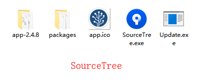

Hi Michael,thank you for your reply!
after I run the installer normally,I can get things installed,contents as the pics shown:
but both of 'SourceTree\SourceTree.exe' and 'SourceTree\app-2.4.8\SourceTree.exe' are not working whether run normally or run as admin.
Nice pictures (thumbsup)
OK, it looks like the installation completed, as such it looks like an issue running the installed app.
