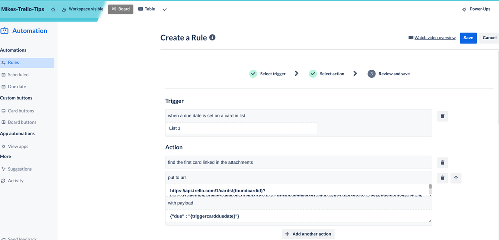

In this example, I am setting the due date of a card in List 1 and the automation will update it on the linked card in List 2

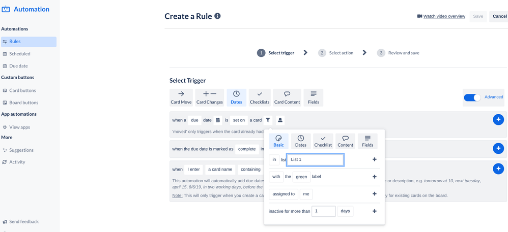

For this, we are going to use the trigger
when a due date is set on a card in list 1
Step 2 - Add the cascade action
In this example, I am going to set the date of the card linked as an attachment to Card 1
find the first card linked in the attachments
The automation looks as follows:
π€ Trello Nerd Step - Add lead or lag to card 2 date
What if you want the date on Card 2 to be 1 week after the date on Card 1. That can be done too...Use this guide as a reference:
https://support.atlassian.com/trello/docs/arithmetic-and-formatting-in-date-variables/
Simply replace the payload above with this one:
{"due": "{triggercardduedate+1w}"}
You can use min for minutes, h for hours, d for days, w for weeks, m for months and y for years
You can also add or subtract by using either + or -
