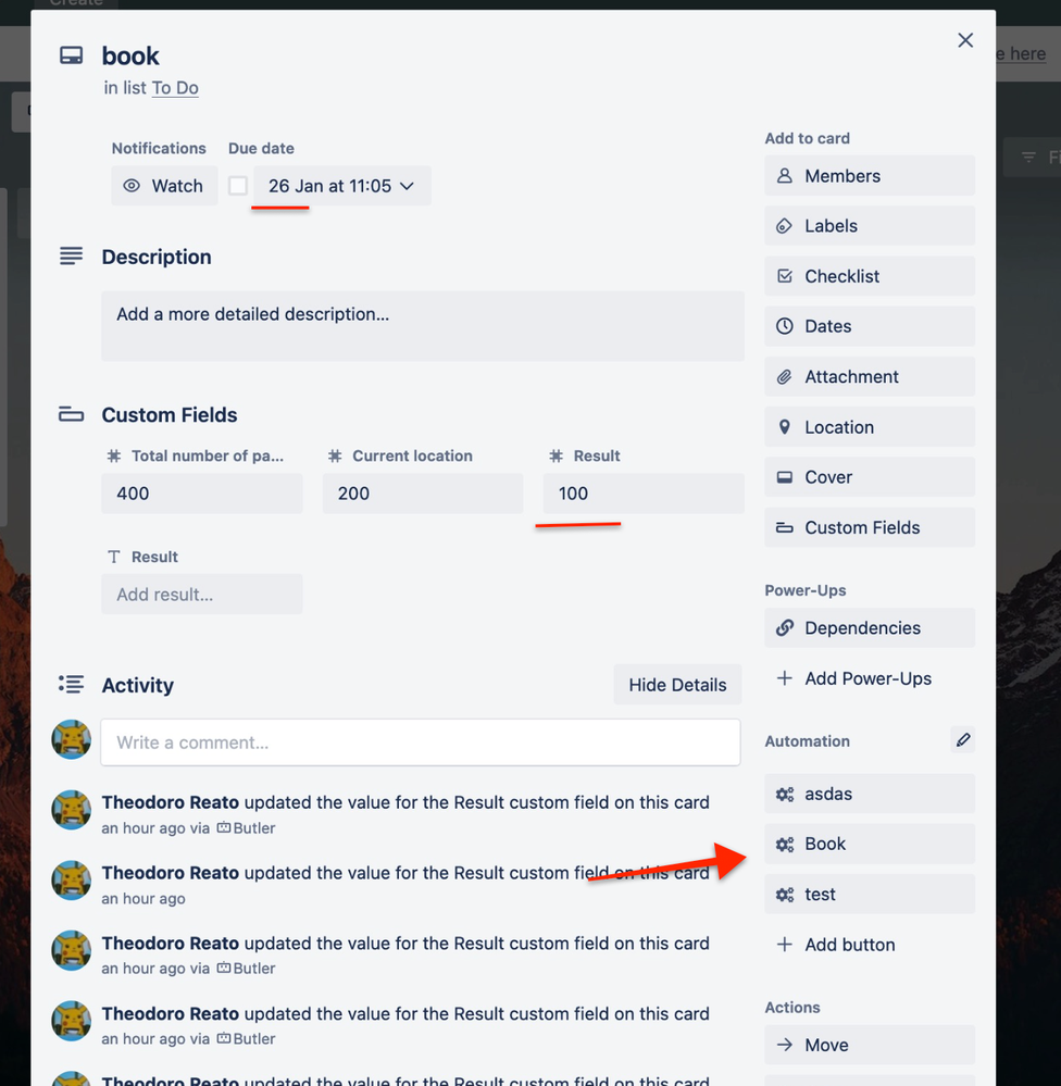

After it, you'll need to choose a name for your Card Button, go to the Fields tab and use the second option "set custom field _____ to _____"
Choose the Custom field you want to insert the result of the formula, on this case we chose Result and paste the following command on the New Value:
(({{%Total number of pages}}-{{%Current location}})/({cardduedate~YYMMDD}-{date~YYMMDD}))
To create this command I used the following articles:
https://support.atlassian.com/trello/docs/arithmetic-and-formatting-in-date-variables/
https://support.atlassian.com/trello/docs/working-with-custom-fields/#Custom-Field-arithmetic
To sum up, to add the value of a Custom Field you need to use {{%___}} and to use a date inside a formula you need to first convert it to a number we made that with the syntax ~YYMMDD, then we used the { } with it as we're obligate while using a variables, and the ( ) to separate the formulas.
After setting the rule you need to have a due date and the Custom Fields Total number of pages and Current location filled out, click on the Butler button and it'll add the results to the Result Custom Field. You'll need to re-click it to update the date if needed.
