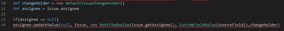

This is the script that I have cobbled together looking at various examples of things that are sorta close.
You can see that the event.issue is causing a problem and that is what the log references:
2022-05-05 10:50:35,729 ERROR [runner.AbstractScriptListener]: *************************************************************************************
2022-05-05 10:50:35,729 ERROR [runner.AbstractScriptListener]: Script function failed on event: com.atlassian.greenhopper.api.events.sprint.SprintStartedEvent, file: null
groovy.lang.MissingPropertyException: No such property: issue for class: com.atlassian.greenhopper.api.events.sprint.SprintStartedEvent
at Script993.run(Script993.groovy:7)
I am not sure how to get around that.  I can't even start to see how the rest of the code is messed up while that is erroring.

Yes the event is a sprint event and not an issue event.  You need to get the issues out of the sprint event as per the example in the Library (although that's for the closed event the logic is basically the same).
So this line here the value would be null.  def issue = event.issue as issue

So in the example, everything above line 21 if (sprintData) is somehow grabbing the issues from the Sprint. Okay. I still don't understand at all how I would call the custom field "Planned Assignee" and use that to populate the Assignee field because the only way I know how to do that is using script with issue in it (issue.assignee, event.issue, etc).
If the example is somehow showing that then I do not understand how.

I'm really sorry I can't test for you but you need to try something along these lines.
import com.atlassian.greenhopper.service.rapid.view.RapidViewService
import com.atlassian.greenhopper.service.sprint.Sprint
import com.atlassian.greenhopper.web.rapid.chart.HistoricSprintDataFactory
import com.onresolve.scriptrunner.runner.customisers.PluginModuleCompilationCustomiser
import com.onresolve.scriptrunner.runner.customisers.WithPlugin
import com.atlassian.jira.workflow.TransitionOptions
@WithPlugin("com.pyxis.greenhopper.jira")
def historicSprintDataFactory = PluginModuleCompilationCustomiser.getGreenHopperBean(HistoricSprintDataFactory)
def rapidViewService = PluginModuleCompilationCustomiser.getGreenHopperBean(RapidViewService)
def user = ComponentAccessor.jiraAuthenticationContext.getLoggedInUser()
def sprint = event.sprint as Sprint
def sprintState = sprint.state
if (sprintState == Sprint.State.ACTIVE) {
def view = rapidViewService.getRapidView(user, sprint.rapidViewId).value
def sprintContents = historicSprintDataFactory.getSprintOriginalContents(user, view, sprint)
def sprintData = sprintContents.value
def issueService = ComponentAccessor.getIssueService()
if (sprintData) {
def issues = sprintData.contents.issuesNotCompletedInCurrentSprint
issues.each { issue ->
def issueId = issue.id
def sourceField = customFieldManager.getCustomFieldObjectByName("Planned Assignee")
// put the rest of your code here
