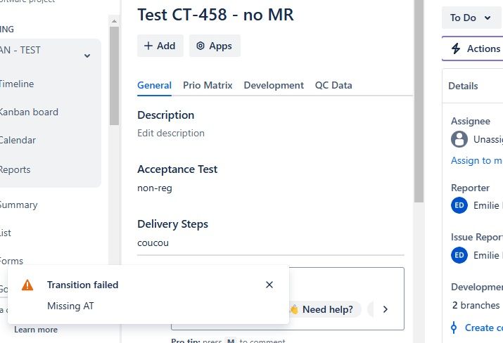

But when we want to transition the issue from the issue view, we get this error:
"errorMessages": [ "Evaluation failed: \"issue.customfield_10052.length > 0\" - operator \">\" is not applicable to types: null and Number" ]
and the error message popup is displayed:
Can you please help me understand why the behaviour is different in both views and how to fix this, so that the validator works wherever the transition is done?

I'm not sure if i properly understand the problem but error just says that you can not check if null is greater then 0. So if you have null in that field it just fails. I just don't understand when you said that sometime it works - on same issue and same customfield values it works on transitioning from boards and on issue view it fails? it would be interesting but maybe on transitioning issue on boards it is not checking validators?
Emilie
February 12, 2025 edited
That's it: on a same issue and so the same customfield values:
  • if the field is empty
    • I can't transition from the board
    • I can't transition from the issue view
    • this means the board checks the validator and behaves as expected
  • if the field is not empty
    • I can transition from the board -> which is OK
    • I can't transition from the issue view -> wich is not OK
And it's the same for the validators we base on text customfields.
What we do:
  • we check that the field exists: issue.customfield_10052 != null
  • and is not empty: issue.customfield_10052.trim().length > 0
Maybe that's not the correct way to achieve that with the Jira expression, I don't really know as it's OK from the board.
The errors began Jan 29.
