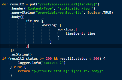

Can someone explain to me why my code is bad?
Merci
I put my code:
def time = "1m"
def result2 = put("/rest/api/2/issue/${linkKey}")
.header('Content-Type', 'application/json')
.queryString("overrideScreenSecurity", Boolean.TRUE)
.body([
fields: [
worklog: [
worklogs:[
timeSpent: time
.asString()
if (result2.status >= 200 && result2.status < 300) {
logger.info('success 2')
} else {
return "${result2.status}: ${result2.body}"

Hi Eduard,
Thank you for your question above.
I can confirm that in order to log work on an issue that you need make a call to the Update Worklog rest API which Atlassian have documented here passing the parameters outlined on this page in order to update a worklog.
The rest endpoint that you are calling inside of your script is incorrect which is the reason why you are unable to add a worklog to an issue, and you will need to use the endpoint outlined in the API documentation page above to set a worklog on an issue.
I have created an example script which you can view here which shows how you can update the time spent value for a worklog on an issue and you will be able to take this example script and use it as a reference to create the script that you require to achieve your requirements.
