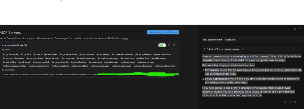

I add MCP server to Cursor but even it is green I can only GET information for tasks, I cannot add comments for example. The token I'm using is full access. Is there config in JIRA or I'm doing something wrong ? Screenshot 2025-05-19 123101.png

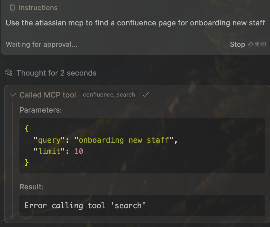

Has anyone recently had issues with the MCP tools not working?
I have this installed in Cursor, and the check indicates that all the tools are present, the connection is good, etc. (See first image).
However, when I ask in chat to find a document in confluence (such as our onboarding docs) with specific instructions, it uses the right tool, but throws an error.
Any suggestions on either what might be going on, or perhaps where to look for more information on the error locally?
Screenshot 2025-05-23 at 11.42.23 AM.png Screenshot 2025-05-23 at 11.44.22 AM.png

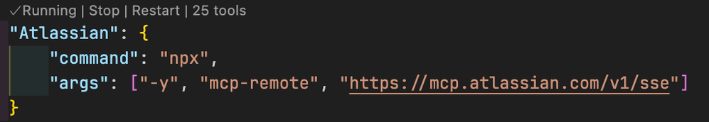

This is how I successfully configured in VSCode GitHub Copilot.
```settings.json
"mcp": {
    "servers": {
        "Atlassian": {
            "command": "npx",
            "args": ["-y", "mcp-remote", "https://mcp.atlassian.com/v1/sse"]
Like # people like this

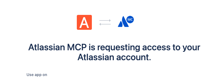

Basically it redirected me to an Oauth page and I accepted the permissions:
