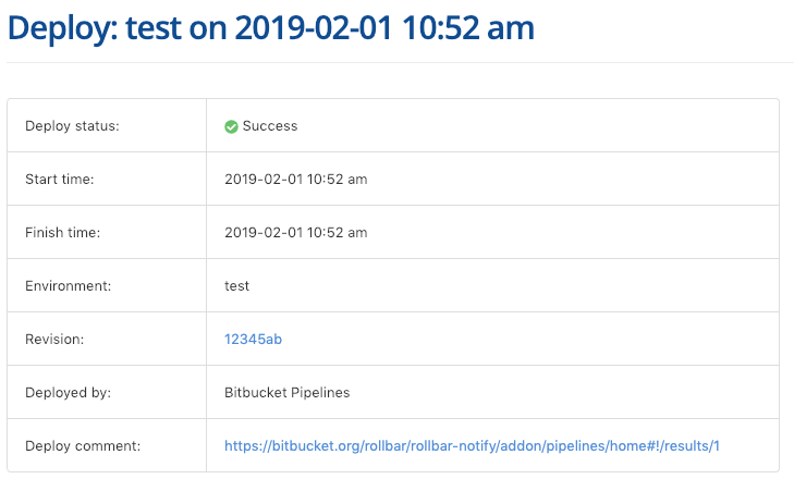

The new deploy could be viewed at https://rollbar.com/Rollbar/bitbucket-pipe-test/deploys/?environments=test.
