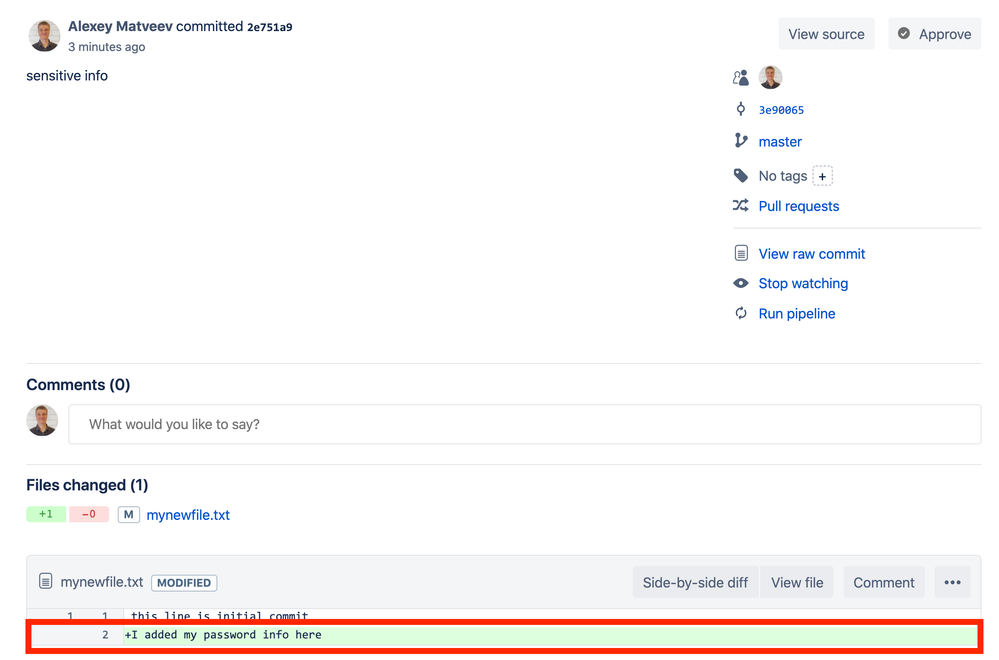

And our commit with sensitive information contains our password line:
