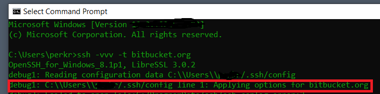

Debug printout from using "ssh -vvv -t bitbucket.org" in Windows command prompt, with some personal info edited out. Also added row numbers to facilitate discussion:
1 - C:\Users\[myWindowsUserName]>ssh -vvv -t bitbucket.org

138 - debug1: Trying private key: C:\\Users\\[myWindowsUserName]/.ssh/id_dsa
139 - debug3: no such identity: C:\\Users\\[myWindowsUserName]/.ssh/id_dsa: No such file or directory
140 - debug1: Trying private key: C:\\Users\\[myWindowsUserName]/.ssh/id_ed25519
141 - debug3: no such identity: C:\\Users\\[myWindowsUserName]/.ssh/id_ed25519: No such file or directory
142 - debug1: Trying private key: C:\\Users\\[myWindowsUserName]/.ssh/id_xmss
143 - debug3: no such identity: C:\\Users\\[myWindowsUserName]/.ssh/id_xmss: No such file or directory
144 - debug2: we did not send a packet, disable method
145 - debug1: No more authentication methods to try.
146 - XXX@bitbucket.org: Permission denied (publickey).
Row 40 - debug1: Authenticating to bitbucket.org:22 as 'XXX'
Should this not be my username on bitbucket? As of now it's the username in my local public key file, listed at the end.
Row 43 - debug3: load_hostkeys: loaded 1 keys from bitbucket.org
Does this mean I'm trying to use my private key to unlock a message encrypted with public key of user XXX, referenced on row 40?
Row 85 - The fingerprint/id for bitbucket server, available on their public website, therefor not CENSORED.
Row 109 - debug1: Will attempt key: C:\\Users\\[myWindowsUserName]/.ssh/id_ecdsa ECDSA SHA256:CENSORED agent
This is actually the key that shows if i run "ssh-add -l" in command prompt.
I hope it means it tries to decode msg from bitbucket.org using this key, not that it is the "publickey" referred to on row 135 and row 146.
Row 131 - debug1: Offering public key: C:\\Users\\[myWindowsUserName]/.ssh/id_ecdsa ECDSA SHA256:CENSORED agent
Now this is unsettling, does my ssh client try to offer my private key to bitbucket.org??? It's the same key as row 109.
Another weird detail is the fact that the username in the public key file on my local computer is the same as the logged in User under Users tab in task manager, it is also the same as the username on row 40 and row 146. However it's not the same as my username in the command window prompt/path, also not the same as my bitbucket username/workspace ID.
I would greatly appreciate it if someone with a deeper understanding of ssh, key-based authentication and bitbucket could help me troubleshoot the issue. Sorry for the behemoth post.

I tried creating the config file you suggested and running the same command as in the picture above. Early on it opens the new config file and uses it, but it still fails with the message "XXX@bitbucket.org: Permission denied (publickey)." on last row. If you compare this image with row 3 in the image above, it's clear the config file is read by the ssh client now at least.
