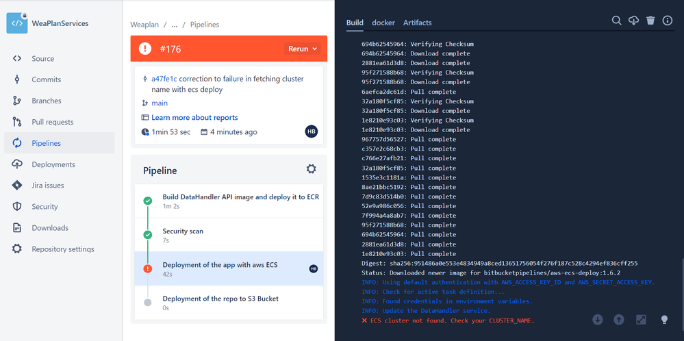

I'm new with the ECS Deploy pipe and have this error in the pipeline that i can't seem to understand . I'd really appreciate your help and thank you in advance.
So i built an image and pushed it into AWS ECR . I now need to deploy the app with ECS using ECS Deploy pipe .
I have created  both a cluster  and service  in aws  as per in the first  picture below  .However, in the pipeline i keep getting the error  that you can find in the second  picture  even though the cluster is clearly existent in the first picture and all parameters  seem correct to me.

@EunoiaCode  hi. Thanks for your question.
First of all please check if you use the correct aws region.
Also you can use in config:
DEBUG: "true"
to have more information in the logs
Regards, Igor.
HB July 29, 2022
Hi @Igor Stoyanov ,
It was actually a region problem .
Thank you for your response.
