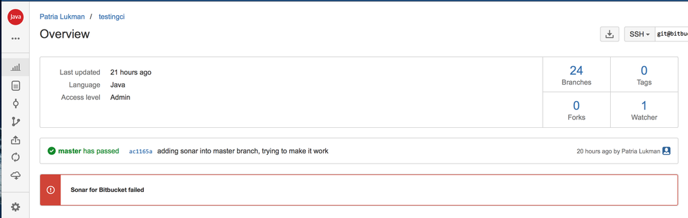

hi there,
Hopefully someone might have a solution to this issue while integrating Bitbucket Cloud with Sonarqube
Here is my configuration:
  1. Bitbucket cloud up and running
  2. AWS instance running our SonarQube instance
  3. sonar.json file
    "sonarHost": "http://ec2-54-86-24-65.compute-1.amazonaws.com:900 0",
    "sonarProjectKey": "com.fresche:xan4cdxacustomers"
I'm getting an error when integrating with the plugin, as shown in the below picture.  Could you tell me why?
Patria Lukman April 28, 2017
Version of the plugin dating 2016 does not work with Sonarqube latest version 6.3 at the time these lines are written.
I have it working with version 5.6.6 of Sonarqube. The plugin developer is working on a patch, so chances are that by the time you're reading mid 2017 ,you should be able to work with version 6.3 of the analysis tool
cheers
