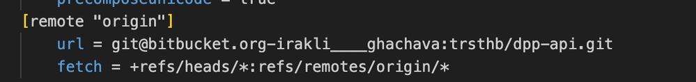

Below you can see 1. my git config 2. remote url in my local git config in repository 3. repo url given by bitbucket by default when cloning 4. my username
Screenshot 2024-10-25 at 00.12.58.png Screenshot 2024-10-25 at 00.12.52.png Screenshot 2024-10-25 at 00.14.16.png Screenshot 2024-10-25 at 00.14.35.png

Hello @Irakli Ghachava ,
the issue is likely due to the underscores you have in the config file.
The appending of your username to the Host entry on the config file is just a suggestion to you can easily identify which account the ssh key that is going to be used was added to. However, you can append any string to the config file, as long as you use the same string in the git remote URL.
For example:
  • SSH config: Host entry set as bitbucket.org-key1
Host bitbucket.org-key1
HostName bitbucket.org
User git
IdentityFile ~/.ssh/bitbucket-nari
  • Git remote URL : The URL needs to match the Host entry of the config file (bitbucket.org-key1)
git@bitbucket.org-key1:WORKSPACE/REPOSITORY.git
Could you change your config file and git remote to match the example above and let us know how it goes?
