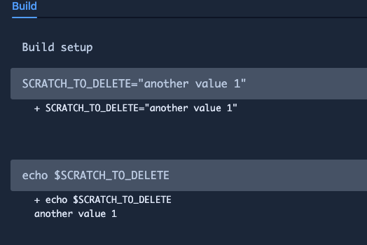

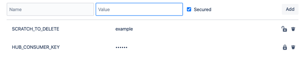

Mikhail Sapozhnikov January 18, 2021
Thanks for the answer. But this is not what I want. I need that after some command, I see the already changed ("another value 1") value in the repository variables

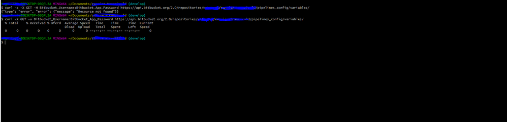

Capture.PNG Hi   @Theodora Boudale,
After doing till the step 3. it doesn't show all the variables (image in attach)
before i used curl -s -X GET -H Bitbucket_Username:Bitbucket_App_Password https://api.bitbucket.org/2.0/repositories/..../...../pipelines_config/variables/
and it worked but now recive an error {"type": "error", "error": {"message": "Resource not found"}}
Can you please help? The idea is to find the COMMIT variable to set with $BITBUCKET_COMMIT so that I can send the delta.
