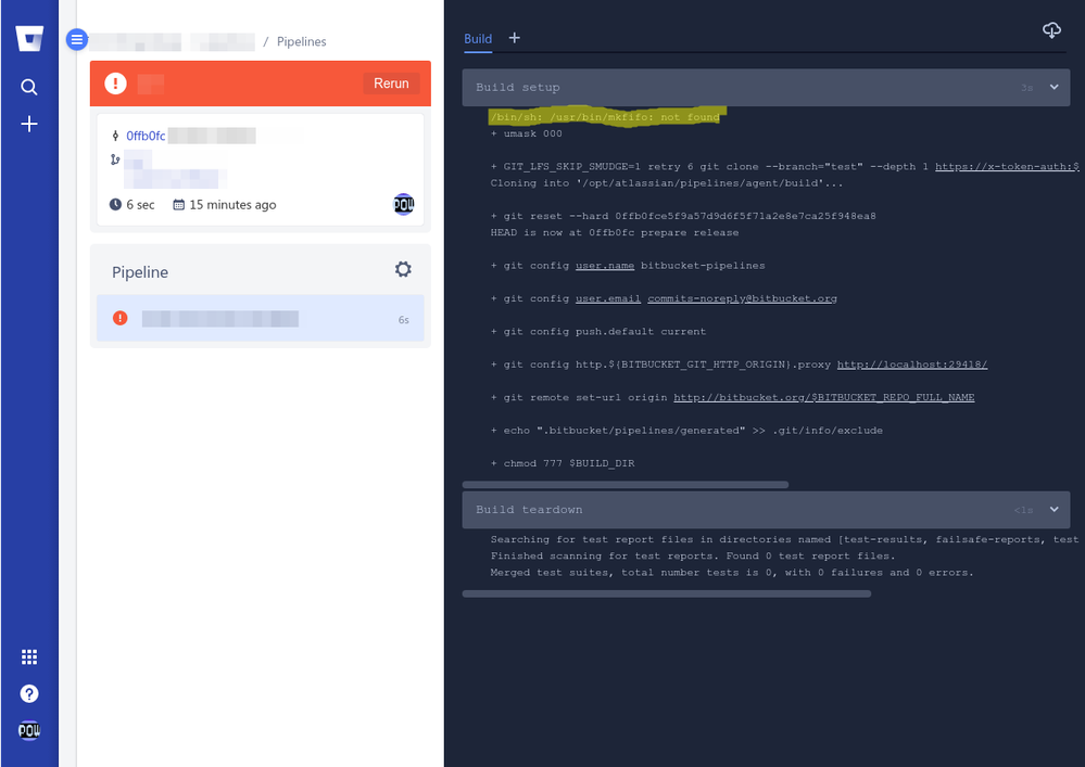

Bitbucket Pipelines shows me in the very first line of the very first operation ("Build setup") the following error message:
/bin/sh: /usr/bin/mkfifo: not found
then this first operation finishes without error, the pipeline step is just NOT executed and next is Build teardown. Here the full log:
+ umask 000
+ GIT_LFS_SKIP_SMUDGE=1 retry 6 git clone --branch="test" --depth 1 https://x-token-auth:$REPOSITORY_OAUTH_ACCESS_TOKEN@bitbucket.org/$BITBUCKET_REPO_FULL_NAME.git $BUILD_DIR
Cloning into '/opt/atlassian/pipelines/agent/build'...
+ git reset --hard 0ffb0fce5f9a57d9d6f5f71a2e8e7ca25f948ea8
HEAD is now at 0ffb0fc prepare release
+ git config user.name bitbucket-pipelines
+ git config user.email commits-noreply@bitbucket.org
+ git config push.default current
+ git config http.${BITBUCKET_GIT_HTTP_ORIGIN}.proxy http://localhost:29418/
+ git remote set-url origin http://bitbucket.org/$BITBUCKET_REPO_FULL_NAME
+ echo ".bitbucket/pipelines/generated" >> .git/info/exclude
+ chmod 777 $BUILD_DIR
Searching for test report files in directories named [test-results, failsafe-reports, test-reports, surefire-reports] down to a depth of 4
Finished scanning for test reports. Found 0 test report files.
Merged test suites, total number tests is 0, with 0 failures and 0 errors.
This looks like an error to me in the build setup as the setup is using something it does not provide.
Also I'm a bit puzzled as my pipeline is made red with no specific error information on the level of the pipeline.
This is how it looks like in a screenshot:
