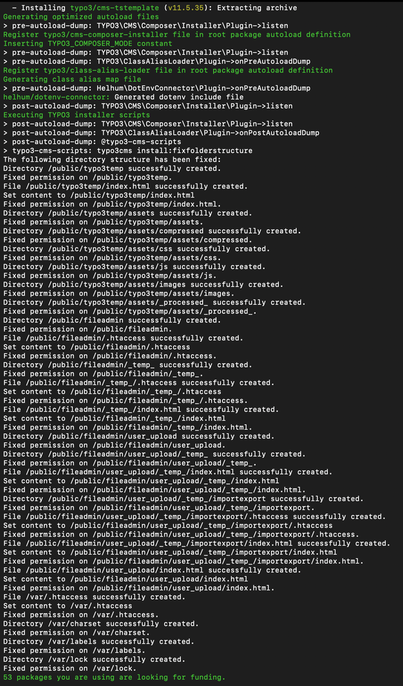

I tested with Docker locally and the same step got through without errors. What can I do now?
Here is the log from my local testing:

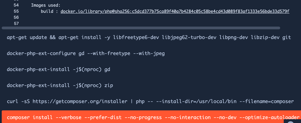

And the exact same log after "Installing typo3/cms-tstemplate (v11.5.35): Extracting archive" from the bitbucket pipeline:

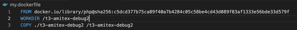

I provided the same image SHA from the failing pipeline. I copied it from the build setup and put it in the Dockerfile:
And this was my Dockerfile:
Mylene

In the output of your local testing, there are several messages about fixing permissions. The output of the pipeline has warnings that plugins have been disabled because the build is running with root user and that this may be the cause of the failure.

The output in the screenshot you shared from the failed Pipelines build includes the following:
Plugins have been disabled automatically as you are running as root, this may be the cause of the script failure.
See also https://getcomposer.org/root
I checked that page, https://getcomposer.org/root, and the very first question mentions that as of Composer 2.4.2, plugins are disabled automatically when running as root, and Bitbucket Pipelines builds run by default with root user.
Even though I don't see in your output the error indicated in the first question, the message about disabled plugins made me think that this might be the issue. My suggestion comes from this page; if I understood correctly, plugins will not be disabled when setting this variable.
