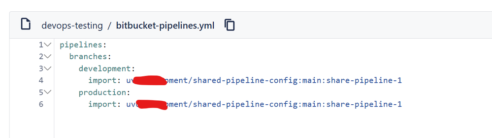

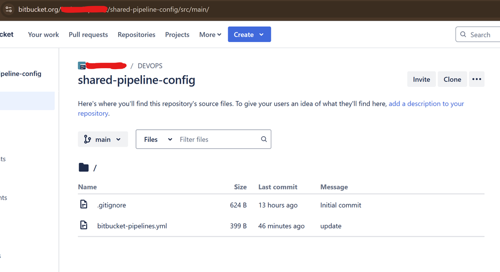

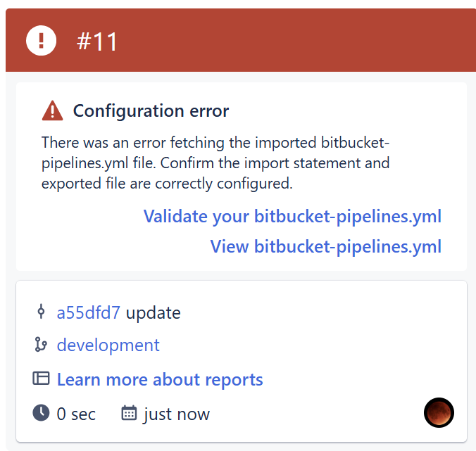

Indra Rizky
June 26, 2025
hi @Ben , thanks for the answer
i already tried it, now pipeline was triggered but somehow the pipeline shows error

Ben
June 26, 2025
Hi @Indra Rizky
To investigate this further - we need access to your workspace, including your YAML configuration and build environment/build logs.
