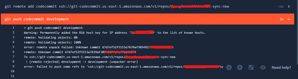

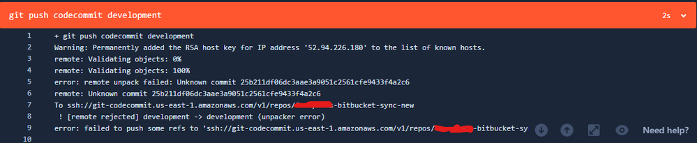

I'm unable to push the code to the codecommit repo from the bitbucket repo using the bitbucket pipeline.
Its throwing the below error. Kindly help to resolve this.

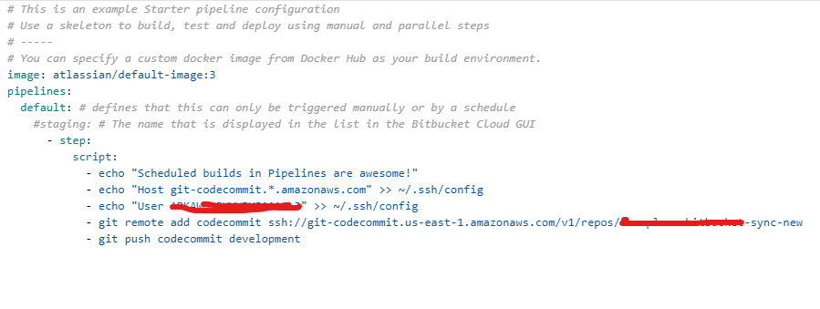

We are using the default pipeline property. FYI, I am including the screenshot of the pipeline below.
Also we have tried pushing the code for the same branch to the codecommit manually, even after that also we are getting the below error. Its showing as "unknown commit" after making changes and when the pipeline runs.

The default pipeline will run on a commit to every branch of the Bitbucket repo.
The git push command you have in your yml file will try to push to the development branch of the CodeCommit repo.
