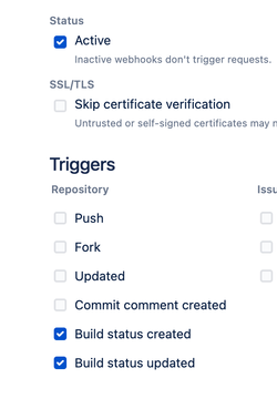

I want to receive webhooks on our own event infra when our BitBucket Pipelines are running. We've enabled the webhooks in the repo settings and selected build start and build update. But the webhooks won't fire.
I've enabled the call history, and no calls show up. We are running our own BitBucket runners and they properly run our BB pipelines.

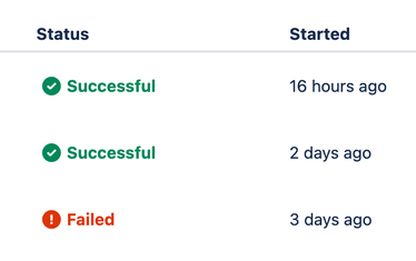

Yes, on the commits page we have the build status, like so:

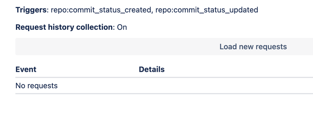

We run builds at push actions and run builds every night by schedule. No requests appear in at the webhooks, even after clicking "Load new requests":

I agree that they should fire on "Build status created" and "Build status created". In my repo I sure see the build statusses:
