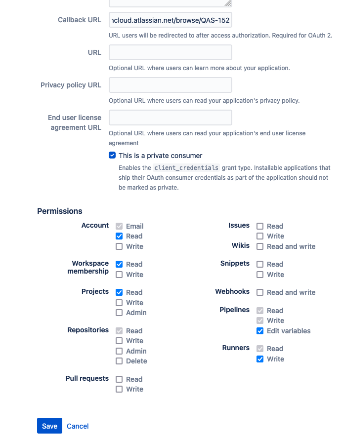

I have a task in jira, and I want to use a automation rule.
With this rule I want to run a pipeline in bitbucket.
I create an oauth consumer in the repository, but when I generate an access token and make the post request I get and status code 500.
Captura de Pantalla 2022-06-10 a la(s) 13.07.22.png Captura de Pantalla 2022-06-10 a la(s) 13.06.52.png

Hello @Mauricio Mondragon ,
With regards to the call-back URL, it's only really needed if you are using an OAuth flow that involves a web browser. From my understanding, you are trying to build an automation in Jira that just involves API calls, so you can put any URL as the callback URL such as https://localhost or https://bitbucket.org, as it will not impact the token that will be provided.

I think the issue here is that you are not providing the correct authentication credentials to the API calls in your automation.
My suggestion here is that you use Oauth client credentials flow, so when you create an Oauth consumer under your workspace settings, you will be provided with a key and secret.
The automation would consist in two steps :
1. Get the access_token by providing the credentials of your OAuth consumer :
You need to call the access_token endpoint to get a Bearer token that will be used in the later step to call the actual Bitbucket API you are looking for. You need to configure the step in your automation as per the below example:
The parameters used are the following :
URL: https://bitbucket.org/site/oauth2/access_token
Headers :
authorization : Basic <Base 64 encoded "key:secret"> Content-Type : application/x-www-form-urlencoded Body: grant_type=client_credentials
Please note that in the authorization header you have to provide the base64 encoded value of your OAuth key and secret. On mac you can base64 encode a string using the following command :
echo -n "KEY:SECRET" | base64
