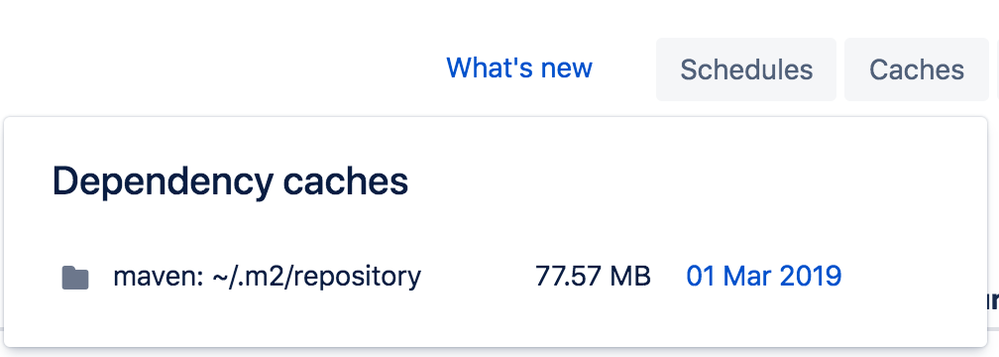

cdov March 1, 2019 edited
Some problem with the cache as it is not updated and stuck in 1.77mb, I deleted the cache and run again the cache went up to 70+mb. now cache is loaded

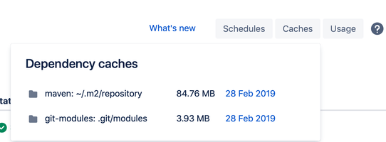

Edwin Kyalangalilwa
February 28, 2019
Please try moving caches as your first step.
Do you see caches as shown? Have you had a successful build?
cdov February 28, 2019 edited
Screen Shot 2019-02-28 at 12.57.22 PM.png the build is sucess, by the way i am using maven 3.6.0 image
