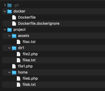

Theodora Boudale
October 11, 2024
Hi Ivars,
Thank you for the info. I'm a bit confused with the ls -p portal command.
Does the directory structure in your repo look like this?
Or is there a directory named portal under the project directory, where assets, home, etc exist?
I have been able to reproduce this with a repo that has directory structure like in the screenshot. Please let me know if I got something wrong in the directory structure.

Ivars Tiltiņš October 11, 2024
Hi Theodora,
Sorry about the confusion about the ls -p portal command, I have multiple projects using basically the same dockerfiles but with different paths, and was simplifying to just 'project'. I guess I forgot to change that there, was supposed to be ls -p project 😅
The screenshot provided looks like the repository structure I have!
