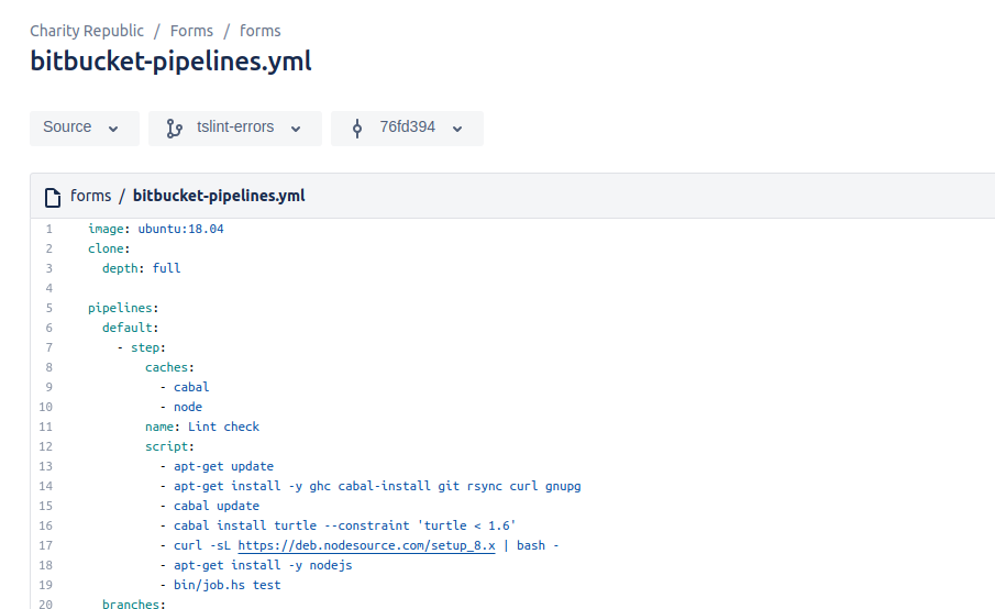

liamcmcdermott September 18, 2018
I tried adding a clone depth of full, but still got the same error. Presumably this only gets all commits for the current branch?
My `bitbucket-pipelines.yml`:

Matt Ryall
September 19, 2018
Hmm, yeah maybe a full clone is only for a single branch. You can see the command in the build setup section. I haven’t had a chance to play with this myself yet.
