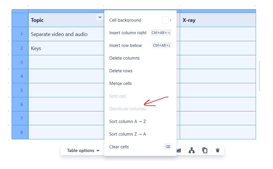

Yehuda Dembsky January 17, 2024 edited
I am facing issues with Distribute columns.
It is greyed.
Any help?
Patricia Modispacher _k15t_
Hi @Yehuda Dembsky,
did you mark the columns?
Like Yehuda Dembsky likes this
Hi Patricia,
Yes, It didn't help
Thanks for getting back on this
Yehuda
