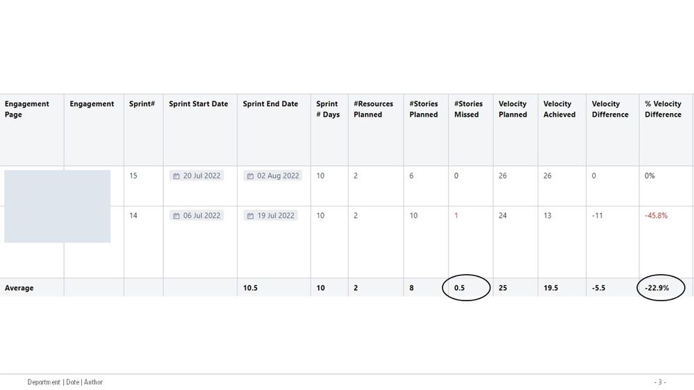

I have a a series of pages with tables of sprint metrics, with an auto-calculated average row.  I am combining those with Table Excerpt Include, then using Table Transformer to flag #Stories Missed values more than 0 in red text using this SQL:
SELECT *,
FORMATWIKI("{cell:textColor=" +
    CASE
        WHEN '#Stories Missed' >0 THEN "Red"
        ELSE "Black"
    END
+ "}" + '#Stories Missed' + "{cell}")
AS '#Stories Missed',
FROM T*
This produces the table below.  The auto-calculated average rows' formatting with gray shading and bold text are overridden by the SQL.  Is there any way to exclude the calculated rows from the SQL formatting changes, or better still, leave the gray shading and bold formatting but make the average value red if > 0?

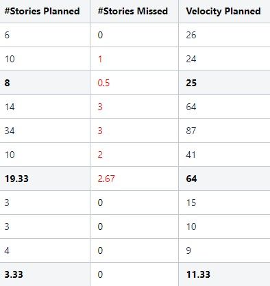

Then you may use a more complex SQL query to apply formatting on the Total rows as well:
SELECT *,
CASE
WHEN 'Project name' = "Total"
THEN FORMATWIKI("{cell:bgColor=#F4F5F7|textColor=Black}", "*", '#Stories Missed', "*", "{cell}")
WHEN '#Stories Missed' > 1 AND 'Project name' NOT LIKE "Total"
THEN FORMATWIKI("{cell:textColor=Red}", '#Stories Missed', "{cell}")
WHEN '#Stories Missed' <= 1 AND 'Project name' NOT LIKE "Total"
THEN FORMATWIKI("{cell:textColor=Black}", '#Stories Missed', "{cell}")
END
FROM T*

Scott Gillespie
January 17, 2023
Hi Katerina,
This is simply excellent--thank you so much!  You understood exactly what I was trying to do, and your code segment works perfectly! I updated it to account for my different cell text labels and different threshold value (>0).  I added another CASE statement to apply red text to another column (see SQL and screen shot below).
This is enough for my purposes, but as a learning exercise, I wanted to apply red bold text to the circled "Average" cells.  I couldn't get it to work, either because I'm making an error in the code, or because the Average values are "virtual" as you say--I am not clear if I can evaluate them, although it seems like I should be able to.
SELECT *,
CASE
WHEN 'Engagement Page' = "Average"
WHEN '#Stories Missed' > 0 AND 'Engagement Page' NOT LIKE "Average"
WHEN '#Stories Missed' <= 0 AND 'Engagement Page' NOT LIKE "Average"
END
CASE
THEN FORMATWIKI("{cell:bgColor=#F4F5F7|textColor=Black}", "*", '% Velocity Difference', "*", "{cell}")
WHEN '% Velocity Difference' > 10 OR '% Velocity Difference' <-10 AND 'Engagement Page' NOT LIKE "Average"
THEN FORMATWIKI("{cell:textColor=Red}", '% Velocity Difference', "{cell}")
WHEN '% Velocity Difference' < 10 AND '% Velocity Difference' >-10 AND 'Engagement Page' NOT LIKE "Average"
THEN FORMATWIKI("{cell:textColor=Black}", '% Velocity Difference', "{cell}")
END
AS '% Velocity Difference'
FROM T*
Katerina Rudkovskaya [Stiltsoft]
January 18, 2023
Hi @Scott Gillespie,
To change the color of your "Average" numbers, check the corresponding parts of your query:
SELECT *,
CASE
END
CASE
END
FROM T*
Here your text color is defined as "Black": textColor=Black. You may change it to "Red" or use any other color as a HEX code.

Scott Gillespie
January 18, 2023
Thank you, again, Katerina.  This confirms the change.  Now I will add logic so the Average row values are red only if they fall into the same ranges as I use for the data rows.  Then this will be the ideal presentation for this page I've been building.
