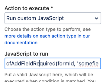

May be you can use the technique and the JS function that is bundled with ConfiForms to do that - https://wiki.vertuna.com/display/CONFIFORMS/JavaScript+functions
Might be easier
Literally just a field definition rule with just one liner (demo adds it to the field named "somefield")
cfAddFieldRequired(formId, 'somefield')

Thank you Alex!!! I had attempted to use the helper function to make it easier on myself but was failing with that as well. I missed the single quotes around the field name, the documentation link doesn't include the single quotations around the field, it is in the demo video (which is very hard to see details without downloading it) but the page link shows: cfAddFieldRequired(formId, fieldName) for the helper function.
Works great now though, with the correct syntax.  :-)

It is assumed the fieldName is a variable that holds the name of the field. But I do agree that the documentation can always be improved
