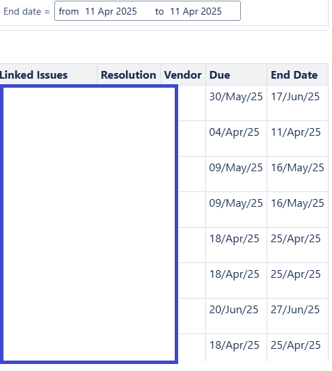

Here is how I set the filter:
And here is result:
It seems to me that there is no corresponding date format in filter macro for the one used in Jira: e.g. 08/Apr/25. Am I right?
If that's true, is there a way to transform it? I can also use Table Transformer.
Thanks.
Stiltsoft support
April 8, 2025
When you add the Date filter to the column, it prompts to type in the required Date format. As you have dd/M/y format in the original table, you should enter this format in the field.
Like • Andrey Khaneev _StiltSoft_ likes this
Nenad Ristevski April 8, 2025
Oh, my bad! Of course, this works! Thanks a lot!
