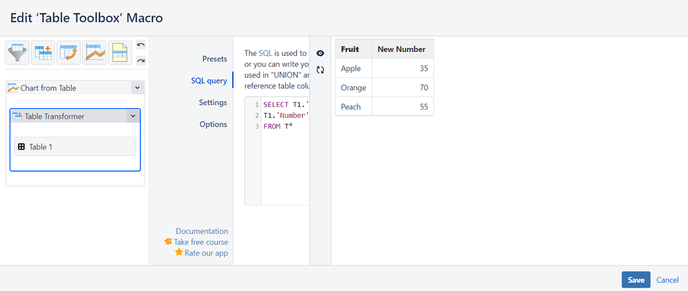

As I see from your screenshot, you are using the Chart from Table macro: it means that you have our Table Filter and Charts for Confluence app installed for your instance.
The mistake that you’ve got speaks for itself: the macro doesn’t see the table inside its body.
It is not very clear how you are trying to process the SQL query, but the pattern should be as following:
Wrap your table in the Table Toolbox macro
Go to the Table Toolbox macro settings and wrap your table subsequently in the Table Transformer macro and in the Chart from Table macro.
The Table Transformer macro helps you to apply SQL query to your table (transform it and perform different calculations).
For example, here I just add 20 to the “Number” column:
SELECT T1.'Fruit',
T1.'Number' + 20 AS 'New Number'
FROM T*
The Chart from Table macro allows you to build a chart based on the transformed table.
Hope it helps your case.
If you are stuck with a query for the Table Transformer macro, you may always refer to our support portal. It is confidential, so you may freely attach a screenshot of your original table, describe what exactly you need to achieve, and we’ll provide you with a suitable code.
