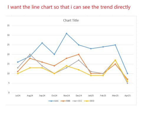

i have two tables(T1 and T2) which comes from different projects, the data of the tables are the tickets which created in JIRA. I had used Table tranformer to merge the data of different team, the SQL are as below. Both table has Lables, but a little different is that T1 labels only include the month info ( such Jan25, Feb24 etc ), via T2 is scrum base, it include both month info and sprint info, T2 labels format is 'MMMYY SPRINTxx:DD/MM/YY'(M=Month, Y=Year, D=Day), so i used SQL to get MMMYY from each table.
Now i want to create a timeline chart which can help the team to see the monthly trend, and it would base on 'Labels'(MMMYY). But when i tried to use Chart from table in confluence to create a time line chart, and found that cuold not work and received error below. But if i changed to column chart, it works. Have no idea why Lables(MMMYY) could not work , can someone please help to check how to fix this problem, how can i create a timeline chart ? Many thanks.

Hi @Aliaksei Mikhailau _Stiltsoft_ ,
Thanks for your replied. Just had attached the result here, could you please help to check if it's the ' the result of Table Transformer macro' that you had mentioned above?
Hello @Oujy_lala,
Thank you for the provided information.
In your Chart from Table please try specifying the date format as My (just type it in). This should help.
