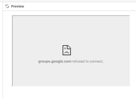

I tested on my own end and I received an error. I assume this is the same you are seeing?
It may require additional settings in order to embed. I'm not too familiar with Google Groups, but let's try something.
Can you go to click on Manage group and then scroll to the bottom where it says Embedding your group, obtain the embed code from there, and try to embed it using the HTML macro
