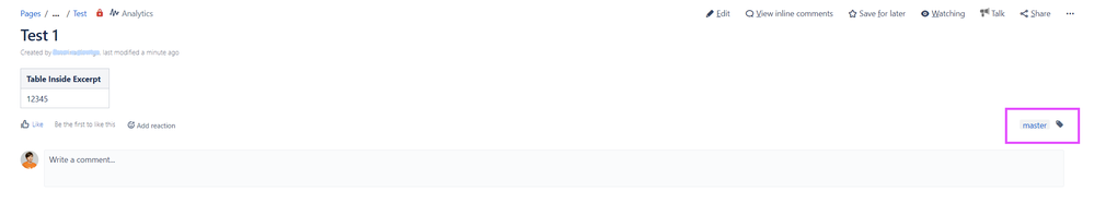

Try to check the same in a more simplified way: here is my source page with the "master" label.
