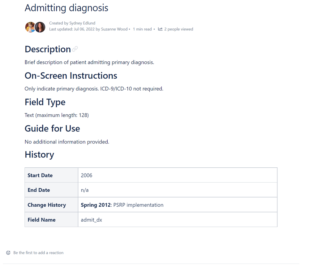

All of the pages in my Knowledge Base have labels. The space has public permissions turned on, but not all pages are viewable currently. We have been working on transferring information from an old PDF format into Confluence for about a year. Today I noticed that on some pages, there are no labels visible in the bottom corner of the published page.
In the first picture, you can see an example page that is fine, the labels in the bottom corner show up as they should.
