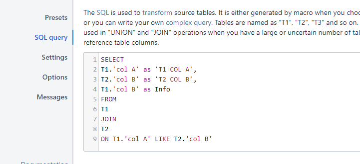

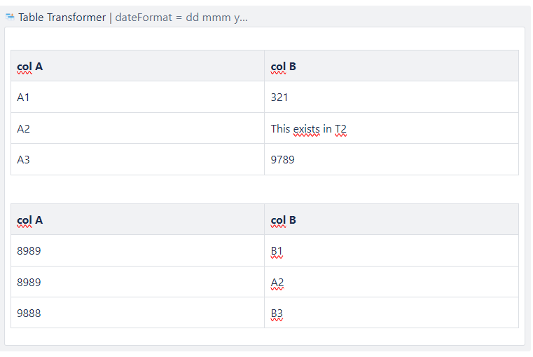

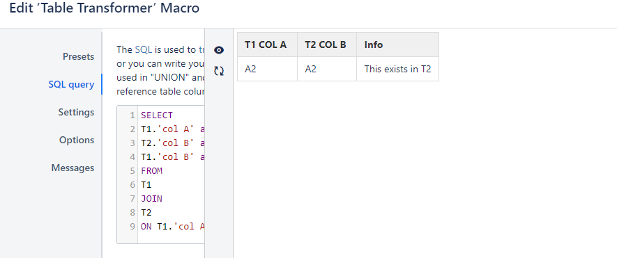

Hi @Craig.Harley , if I understand the question correctly I'm not able to reproduce this error, that means I get values returned when trying this.
I have the following setup.
Result:
Or with some added info:
Are you able to attach some images from your setup? It might help finding the root cause of the problem you experience.

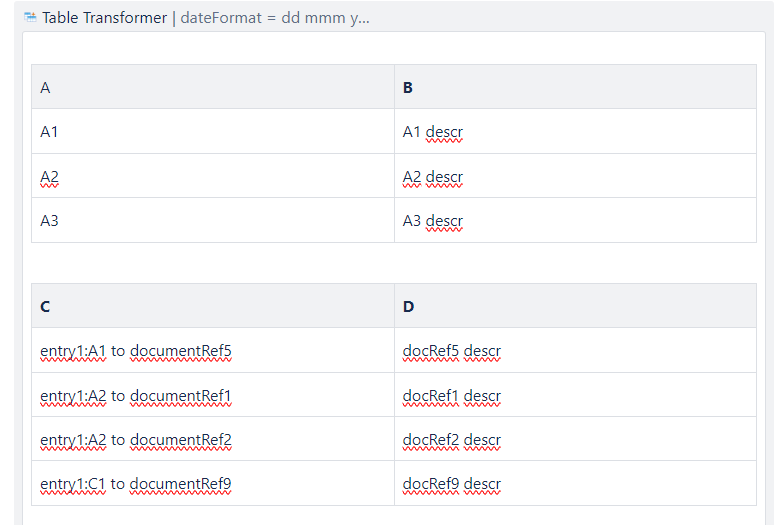

Craig.Harley
November 15, 2023
Hi Tim, it would be a match as "entry1:A2 to documentRef1" contains A2, apologies if I have been a bit vague
In addition with the format, the field matching would always be directly after the colon ":"
Tim Kopperud
November 15, 2023

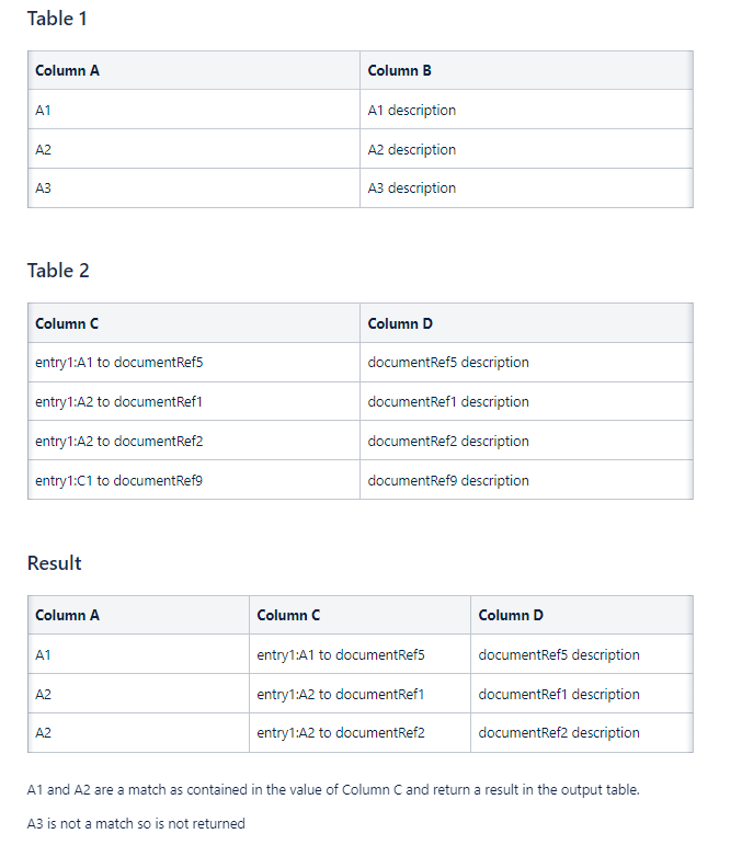

Hi @Craig.Harley, if I have understood the question correctly this example might help
SELECT
A, C, D
FROM
T1
JOIN
T2
ON C::string->split(":")->1::string->split(" ")->0 = A
We here
  • first split the string retunrned from C by ":" and then fetch the second value from the split array which is index 1, hence "->1"
  • then we split the returned string by " " (space) and fecth the left most value which is split index 0, hence "->0"
  • we can then match the result with A in the JOIN ON clause.
Result:
Source:
Hope this helps.
TimK

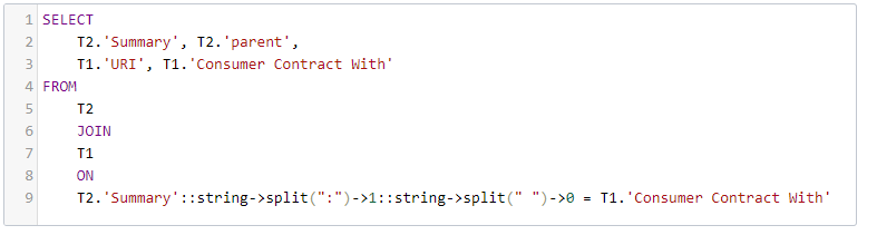

Craig.Harley
November 15, 2023
hi Tim, tried this, but get the following error returned

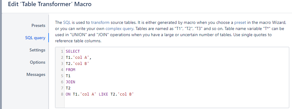

Craig.Harley
November 15, 2023
as requested

Hi Tim, the error doesn't show up below the sql statement, but instead appears here

Stiltsoft support
November 16, 2023
Hi @Craig.Harley ,
Maybe this more general option will do for you:
SELECT
'Column A', 'Column B', 'Column C', 'Column D'
FROM T1
JOIN T2 ON T1.'Column C' LIKE "%" + T2.'Column A' + "%"
