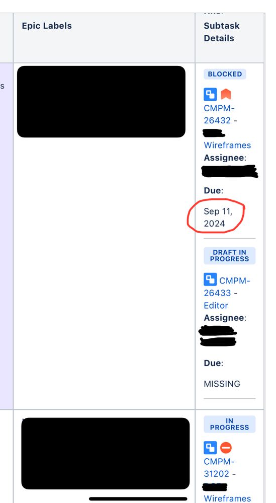

×I’m using the below SQL in a Table transformer Macro to group epic information (in table 1) and subtasks information (in table 2 - an epic might have more than one subtask).
Note: Table 2 is surrounded by another table transformer (transformer inside transformer); this transformer makes the font of the DUE field red if past due, or Green if date is in the future.
The issue I’m having is when using the below sql seems like the CONCAT_VIEW_AGGR is somehow removing the formatting to the font color I have set for DUE.
Any ideas? I tried adding a FORMATWIKI around T2.DUE (as seen below) but it keeps removing the font color.
The documentation from Stiltsoft on advanced transformation does not cover these type of scenarios.

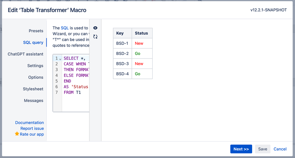

In the internal Table Transformer we color our statuses conditionally:
SELECT *,
CASE WHEN T1.'Status' LIKE "Go"
THEN FORMATWIKI("{color:green}", T1.'Status', "{color}")
ELSE FORMATWIKI("{color:red}", T1.'Status', "{color}")
END
AS 'Status'
FROM T1

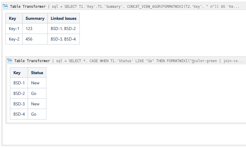

In the external Table Transformer we group our tickets:
SELECT T1.'Key',T1.'Summary',
CONCAT_VIEW_AGGR(FORMATWIKI(T2.'Key', " \n")) AS 'Key - linked issues',
CONCAT_VIEW_AGGR(FORMATWIKI(T2.'Status', " \n")) AS 'Status - linked issues'
FROM T1 LEFT JOIN T2 ON T1.'Linked Issues'->split(" , ")->indexOf(T2.'Key'::string) > -1
GROUP BY T1.'Key', T1.'Summary'
As you can see, the statuses in the last column were grouped as well but the colors remained as they were after the conditional formatting.

see sample attached (the date is in fact red in when only looking at my second table), but the color disappears when combined columns are used:

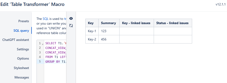

It doesn't matter if you aggregate cells within the same column or several columns at once:
CONCAT_VIEW_AGGR(FORMATWIKI(T2.'Key', " \n", "Status is:", T2.'Status')) AS 'Key - linked issues',
As you can see, I've added statuses to the third column - the colors remain as they are.

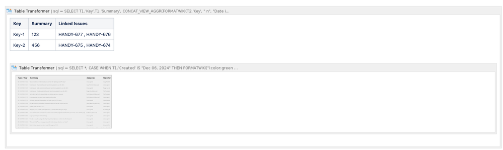

Also I've taken the live Jira Issues macro as T2:
SELECT *,
CASE WHEN T1.'Created' IS "Dec 06, 2024"
THEN FORMATWIKI("{color:green}", T1.'Created', "{color}")
ELSE FORMATWIKI("{color:red}", T1.'Created', "{color}")
END
AS 'Created'
FROM T1
CONCAT_VIEW_AGGR(FORMATWIKI(T2.'Key', " \n", "Date is:", T2.'Created')) AS 'New column'
So, as you can see, it also doesn't matter if you work with manually created or macro generated tables.
