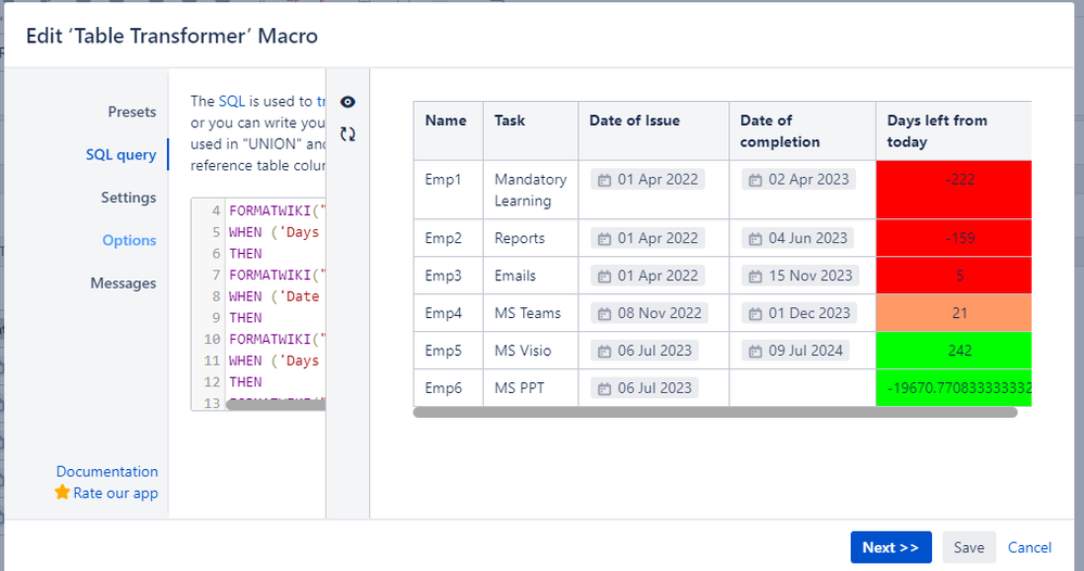

BUT, when I try to enter a date on Date of Issue and leave Date of completion empty, I get the strange value below. I understand it is a calculated cell. I assumed I already asked the code to consider the NULL values in all the 3 columns and to provide a result as a blank cell or clear coloured cell

So, you are correct that you get strange numbers because you calculate the 'Days left from today' column:
DATEDIFF(day,'Date of completion',"today")
No value in the 'Date of completion' column causes an error.
If you decide to calculate, for example, the date difference between 'Date of completion' and 'Date of Issue' columns, then both these columns should contain proper dates.
So, here is a workaround for the case: you may modify the query that goes to your internal Table Transformer macro.

Here we just check which fields are missing and mark them with a specific text (status).
Later in the external Table transformer macro we will be able to color these cells (an empty cell can't be colored!):

My example is a general one, for your specific case there is no need to check if the 'Date of Issue' contains data as you don't need it in the formula.
So, you may just leave this query for the internal Table Transformer macro:
SELECT *,
CASE
WHEN 'Date of completion' IS NULL
THEN ""
ELSE DATEDIFF(day,'Date of completion',"today")
END
AS 'Days left from today'
FROM T*
and get an empty cell instead of the strange error number.
In the external Table Transformer you just remove the bold part where we color the missing dates by statuses - as you don't have any statuses, you don't need to color by them. Your conditions will work with numbers and empty cells will remain as blank empty cells.
