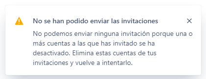

June 15, 2022 edited
Jira Cloud
hello I have a similar problem, in my case I deleted a user, then I invited him again and he did not let me send the invitation because it says that it is deactivated, when in fact it no longer exists. What can I do there?Rechazo de invitación.png
